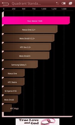

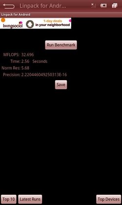

Yep, and its butt still hurts... Now it can spank. :D
(1) Root http://www.androidtablets.net/forum...ot-official-huawei-s7-android-2-2-builds.html
(2) Recovery http://www.androidtablets.net/forum...y-recovery-huawey-s7-2-2-2-cm-v2-5-1-8-a.html
(3) Set Up Apps2sd to install applications to an ext2 partition.
http://www.androidtablets.net/forum/huawei-ideos-s7-development/5362-prj-apps2sd-discussion.html
a) I used kevmueller's process replacing 179:18 in the commands (and in the init-sd.sh file) with 179:2 (for my S7-104 BB version) http://www.androidtablets.net/forum...5362-prj-apps2sd-discussion-13.html#post33905
(4) Installed SetCPU and set it to 998MHz
(5) Installed Swapper for Root Users and set up a 256MB swap file on the ext2 partition
https://market.android.com/details?id=org.azasoft.free.swapper (Can be downloaded from your phone through the Market).
(6) Installed SD Speed Increase and set it to read SD at 4096.
https://market.android.com/details?id=com.sdincrease.it (Can be downloaded from your phone through the Market).
..and let `er rip...
I can now say that I am again happy with my S7 :cool:

I'm getting similar scores. I also got those using 2.1. I think using app2sd makes a huge difference.
Without app2sd setup, I was getting in the 800's (I think). Link2SD also had similar lower scores (I think).
Did not do steps 5 or 6. Just rooted, apps2sd, mine defaults to 998MHz.

The swap doesn't help any with benchmarking scores. But the SD Speed Increase app seems to help. Android has it set by default to read at a paltry 128kb. I had it set to 4096. Most people get best results at 3072.
