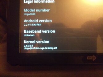

Right my hwver using 'cat /proc/cmdline' is 11.2.0.6. I've produced the dump using dd but can't find my microsd adaptor/get busbox to install/get gmail to attach but i'll keep trying.

Edit: Image of screen $DSC_0089.jpg
