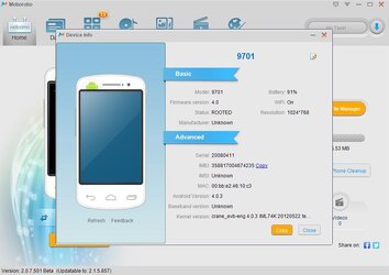

Ok, I bit the bullet and went ahead with this for the Rockchip RK3066....
How to Root Rokchip RK30xx Android Devices - Ngopdul.com
And according to the result the 9701 is now rooted.
So what do I do now to reset the battery info please??
