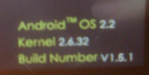

I have a problem with my tablet. I try to open it, and freeze to start.
I tried to full reset, without success. I am waiting to open about 15min but never continued and stay to first image.
Any help would be welcome.

Nothing happens. Just again freeze on start.
There may be no solution. Is there a link how to reinstall android or if anyone knows how to install any linux distro on it?

I wouldn't waste any time trying to fix the stock ROM. Get the uberoid version (check link in my sig - you'll need to register first) and put it on a sd card and then install it.
