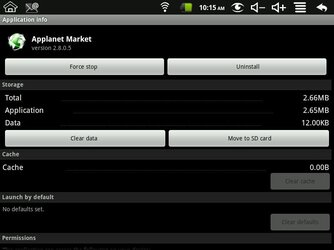

yugten
Jul 16, 2011
8
i followed the procedure but when i ran the applanet it wont show apps except the top portion of the website. as shown below
this is the version of applanet i had installed
below is my tablet specs.
appreciate any help from you guys!
