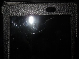

My own A100's screen has just been broken too.
For the 'were you using a case' questioning: yes, I had/do have one, wallet styled, with an opening on top. On my broken/cast arm, hold to the vertical tilt, it slipped off and fell angled on a single corner.
It's now aesthetically ugly, but 100% usable and with almost no reading drawbacks.
Before this incident, I already have had ordered a pack of SkinDigital's excelent anti-glare film.
I hope they will make the cracks a little (or a lot) less noticeable for the difusion of the light.
On SkinDigital's. THESE I garantee: SkinDigital Store - Cases & Accessories For Tablets, eReaders & Mobiles!

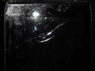

Enriching the post, here I present you to the damage.
Although the seriousness of these cracks, there's no noticeable loss on sensitivity even on the most damaged areas.
And the broken glass, at least to this moment, shown to be harmless.
The most severed areas are kept hidden when inside the case, as shown below.
Hence, I'll wait a little more before spending hundred bucks ordering that kit.
Shall any of you try that, please, keep us posted!

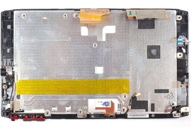

My LCD screen underneath the glass/digitizer is cracked.
I have an Acer Iconia Tab a100, a pretty nice little device.
Sadly I was foolish and didn’t buy a protective case for it. (I have been buying cases for certain ever since this debacle)
It dropped and the inner LCD screen cracked, preventing it from operating.
The outer glass and digitizer appear to be intact and I would have handled the repairs myself but there is one part I am just not confident in.
http://www.techrepublic.com/blog/itdojo/acer-iconia-tab-a100-teardown-lots-of-tech-crammed-into-7-case/3028
The tablet seems to be mostly easy to take apart and navigate, but the LCD itself is apparently glued very well to the digitizer and I don’t have any tools that would be able to handle the job of removing the two parts.
I am fortunate that the LCD itself is a cheaper component
http://www.parts4repair.com/7-acer-iconia-tab-a100-lcd-screen/ (example online)
The digitizer/glass front is far more pricey. So I don't want to %%&$ that up by haphazardly trying to tear the massively glued screen from it.
It looks almost fine when it’s off.
It’s when you turn it on that you see the screen damage.
Anybody know what sort of tools/techniques I would need to remove these two parts from each other without damaging the gorilla glass/digitizer?
I'm unable to find any advice online for this :(

I ripped mine apart before I ordered anything and my screen was not glued or taped to the top digitizer, however it did have 2 little strips of tape on the backside of the screen to help hold it against the digitizer. But not taped like say a phone screen. It is actually held in place with a metal plate and some screws. I did buy mine refurbished from the acer store but I would Imagine they would rebuild it properly.
