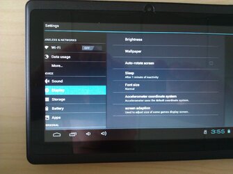

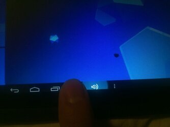

But I still have one more issue after the firmware update. Since the update.. the screen is skewl about 1/2 inch to the right of the device. See attached picture. The area highlighted in yellow is unusable. Do you have a solution for this problem. I tried reflashing the firmware several times, but still have the same problem. All the icons are also misaligned. Second picture show my finger on the 'lower volume" icon but the "increase volume" icon were activated.
