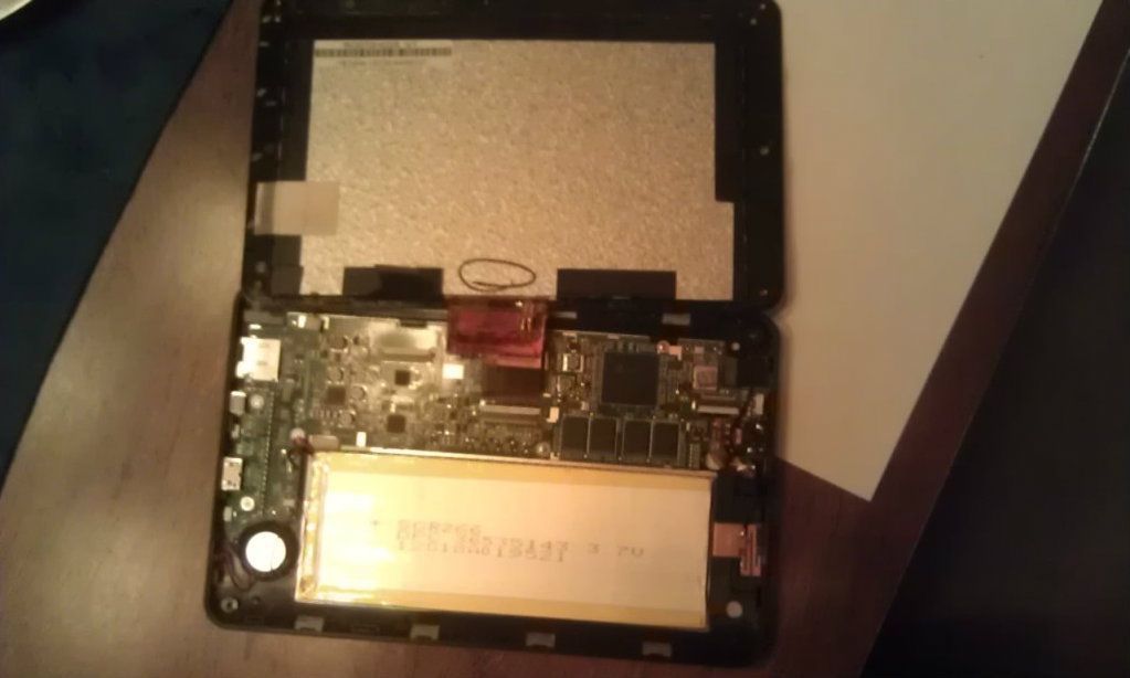

Ok, I stopped maps (can't uninstall) and stopped facebook too. Ran the same movie and it died at the same time as before, about 2:50 of video playback.
Looking further into the Onda chinese site, they don't list the V711 battery size. I can only assume that it is the same as in the V712 which is listed as 3000mAH.
Since I am really curious, I decided to crack it open and take a look at the battery inside. Unfortunatly, no mAH rating here either. If anybody can find any info on this battery through the numbers, that would be awesome.
Look:
The battery measured ~143x53mm
If anybody finds a good hi-cap replacement, let me know.
