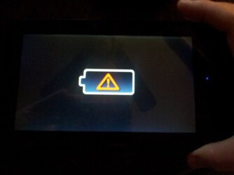

I was using my android tablet (MID--google tablet) and the battery was getting low. I plugged it up to charge and when I went back to use it about an hour later, there was a black screen with a battery on it. There is a triangle with an exclamation point in it. I unplugged the charger and tried to turn it on, but when I hold the power button, that pops up instead of starting the tablet.
I have no idea what is wrong with it or how to fix it.
Any ideas? What can I do to fix it?? I use my tablet ALL the time!
I really appreciate the help...TIA!

looks like its not charging, that screen means it needs charging before it will turn back on.
battery or charger fault? have you got a multimeter to test either?

Where do I take it to test the battery? I had it plugged up charging all night and it still had that this morning.
I am not sure what a multimeter is?? I have tried the wall charger and also the adapter to the computer...neither worked...when I plugged it into the computer the computer chimed like it does when there is something connected to the port, but nothing ever came up on computer or tablet.

if you dont know what a multimeter is, take it somewhere to be repaired - unless you want to learn basic electronics quickly ;)
the multimeter would be used on the battery connections to check the battery is ok, and if the charger is charging.

1st remove the batter for few mints 5 or 10, (open ur tablet and remove it, or PUT your batter IN DIRECT-SUNLIGHT for atleast 5 HOURS,.than attach again, if still not works than follow below mentioned options.)
2nd arange adapter (if batter operate on 5vdc than arange 10 6.5 vdc adapter)
3rd connect batter with adpter for 5 mints (make sure Positive wire connect to positive terminal on battery)
4th plugein battery again and enjoy.
NO NEED TO DO ANY OTHER THING LIKE UPGRADE FIRMWARE ETC>

Dear PakastaniKing, the 9" Polaroid Tablet Quad Core doesn't have easily detachable connections from the batter to the motherboard. They are soldered together. Do you have any other options?

I had exactly this problem just now on my Samsung tablet. I was using a low voltage plug (9v output). With this I was getting the same problem you just mentioned; black screen, battery with a triangle and an exclamation mark.
I decided to try a higher voltage charger, and hey presto, the problem was instantly fixed.
Hope this helps.
