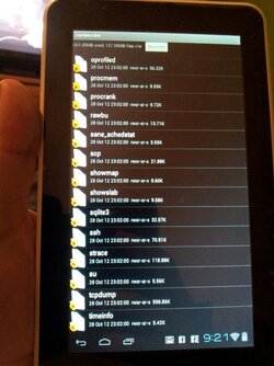

The thing is that there's already SU in the System/xbin folder (see photo).
I thought of upgrading SU but it fails due to permission problems on the folder.
That's how I've always fixed partial roots on my other Android devices, except this one.

that su doesn't look correct, you have cwm recovery installed? that size is a dummy file not real.
