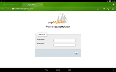

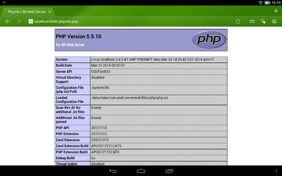

I also tried Droidphp but lack of documentation stopped me, so I bought Bit Web Server and managed to move the root folder to my external SD card, and tested phpinfo and phpmyadmin. I'll test some other things later.

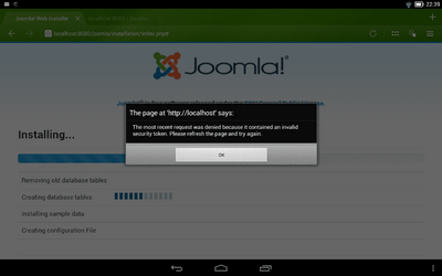

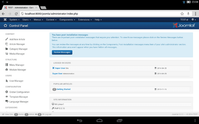

Two more for you, got joomla! installed, needed to use Chrome to install it because Dolphin was giving me a security certificate error.
