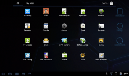

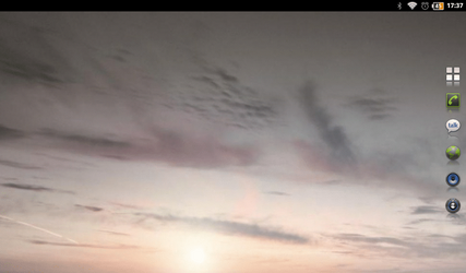

V1.1 Screenshots
V1.2 Screenshot (Market)
V1.3 Screenshots
