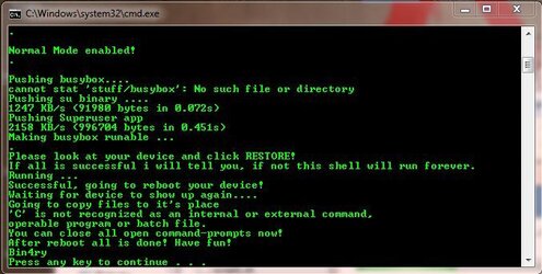

Nov 27, 2012
7
$problem.JPG so here is my problem

Wouldn't you need root to move it
no within the root utility filestructure on your pc
mv ../stuff/install/busybox ../stuff/busybox
judging by your screencap you there is another error with in the script
**** here dl this https://www.dropbox.com/s/kbhyntbfddb36qp/RunMe.bat and replace the .bat in you utility directory..... it looks like the c error is because it is supposed to be a shell command but busybox was never pushed.
cm.stites
Nov 26, 2012
got mine working today... definetly make sure you have the files downloaded straight to the desktop and not to a folder on the desktop.. and also make sure that adb.exe is not running before trying to install the google apps after rooting.
