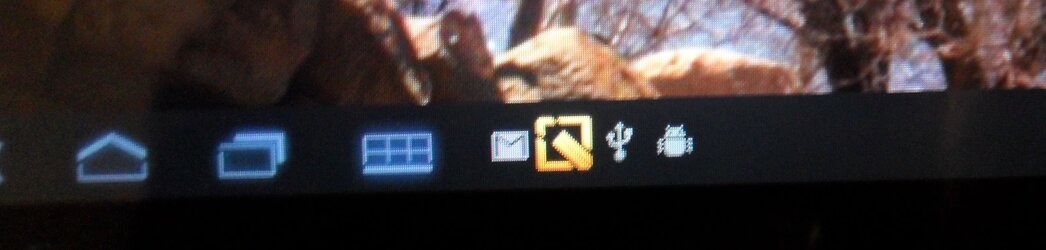

1. Switch on your Android tablet or CUBE U9GT 2, connect it to your PC via USB. On the menu bar below your tablet screen, you would see a USB connection and Android symbols (meaning a device has been connected to your tablet). The last two symbols on the right side of the menu. See below:

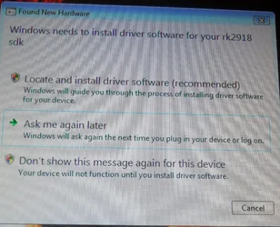

Meanwhile, your PC must have displayed a message saying "Windows need to install driver software for your RK2918SDK" as shown below, JUST INGORE IT.

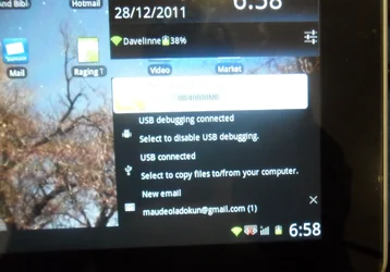

2. On the far right corner of the same bar menu bar below your tablet screen, you would see a clock, battery level, wifi etc symbols, touch the area and a task menu or bar would pop up, it should looks like this below:
This should show other task running on your tablet at the moment.
3. Select the "USB connected, select to copy files to/from your computer" link.

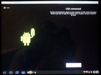

4. Your tablet screen must have changed to what looks like this below:
Note: The colour Android symbol is green at this stage.

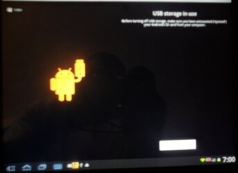

5. On the far right below corner of your tablet screen, you would see a grey or white button with text "Turn on Mass Storage" or something like that. Touch it and this would activate mass storage function of your tablet internal storage and if you have SD card (including your SD card connected to your tablet) on your PC and you would be able to copy files to/from your pc.
6. The screen of your tablet should look like this:
Note: The colour of the Android symbol now turned to orange, showing that mass storage function is running. You can do other things on your tablet as usual but the mass storage locations on your tablet may not be available untill you disconnect it from your pc.
