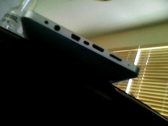

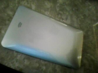

Well, so much for that I still get an error on that. under the getprop info. the serial info is F1002059B0034012110831152142000. but I also found under [wifi.eng.anabled]: [false] and the [net.hostname]: [android_f0d0747918d35822] could this host name is using the mac address to idenfied itself to the network? by the way here are the image of what my tablet look like: $IMG0000.jpg$IMG0001.jpg$IMG0003.jpg
Perhalp, I might have the wrong firmware for my tablet. if you know where I can get the correct one, please direct me to it.
