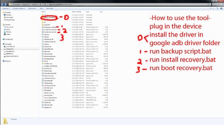

1. download drom and place it on your sdcard Link here
2. download hack pack and unrar it with winrar Link here
3. install adb driver when tablet is plugged in so your pc can "talk" to the tab this should be in the hack pack in google adb folder(this is a win7(x64) driver)
after running the 3 bat files in the hack pack you should be in recovery
4. wipe everything except your sdcard and install drom
