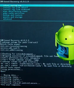

What I did:
Enabling USB-Debugging mode
With my linux box:
Code:
root@sv:~# adb reboot bootloader
* daemon not running. starting it now on port 5037 *
* daemon started successfully *
Code:
root@sv:~# /install/androidins/adt-bundle-linux-x86_64/sdk/platform-tools/fastboot -i 0x17ef boot '/install/androidins/ideapad_downloads/lenovo_a2109a_downloads/cwm_for_4.1.1_md5_6957151c118956b401445e042064be85/a2109_cwmrecovery-6.0.1.9d_md5_6957151c118956b401445e042064be85.img'
downloading 'boot.img'...
OKAY [  1.013s]
booting...
OKAY [  0.220s]
finished. total time: 1.232s
So I should have the "d"-version for 4.1.1
Then I changed to the tablet following the menus. See next posting. I have troubles to upload photos.

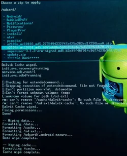

So I did:
erasing dalvik cache
checking permissions
wiping data
wiping cache

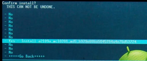

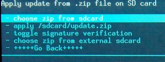

trying to flash 2 zip files with the same md5sum, but one was name "update.zip"
What can I try?
I solved it, I had to install superuser-3.1.3-arm-signed_md5_b3c89f46f014c9df7d23b94d37386b8a.zip again and before a2109a_mcl0201_md5_b979e686a5845f64a4e76d53724cbb70.zip
