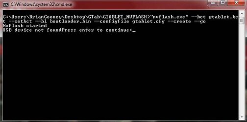

Im still not 100% on the NVFlash thing. I understand how to flash and as I said I flashed the device with NVFlash originally to get CWM on it. But when I plug the device in to the PC now it isnt recognized at all. Not as an unknown device, not as a USB device. It just isn't showing up n device manager at all. There is no audible notification as to a USB device being plugged in either. If the tablet is powered off and you plugged it into a PC would it be recognized?

Nope, unfortunately not necessarily. Do you already have the full NVFlash set up on your pc then?

Yes sir. Installed the APX driver in Windows for the new device and it flashed successfully.

ok, so pls just try connecting the tablet, and then go to the directory and run the nvflash_gtablet.bat file and lets see what happens
I did that already, but just retried with the same error. USB is not connected as you can see below:

ok...we are going to keep trying.
Now i want you to unplug the tablet, Press the Volume DOWN and hold it, and then press and hold the Power On button. You may (or may not) see the 3-birds, either way, hold it for about 30 seconds then plug it back into the USB and try NV Flash again
