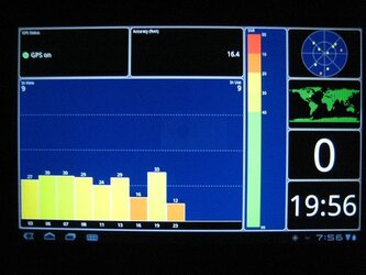

It takes a bit to get the satellites the first but mine works great. There is a great free app called GPS Status that will help aswell.does anyone know how to make GPS in Iconia work? I have turned on GPS on my cell phone and it has found 3 GPS satellites. but when I turn on GPS and map program, but it cant find any satellite at all.

If you browse a few of the tablet forums, you'll notice three major (and one minor mystery) complaints regarding the A500 being mentioned over and over again:....This morning, I started it back up on the A500. Surprisingly, it came to life very quickly (compared to the first time) and now, while inside near a window, it sees 7 to 8 satellites and as 5 to 6 in use. So, I conclude that the GPS device in the A500 is not super sensitive or fast, but it seems usable.

Unless your GPS never acquires and locks on (even outdoors) and your Wifi is completely unusable- you may have to go through many, many A500's to see any noticeable difference in the GPS and Wifi performance over your current A500 (you could even get one that's worse)....Your #2 and #3 are the major issues for me. I might have to return it and buy it again to ensure I get a working unit.
Slow/weak GPS and weak Wifi just seem to be the norm in the current crop of A500's.
In real world use, i.e. using the A500's GPS in my car this morning- it saw 10-12 sats and was using 6-7 at any given time for 16ft accuracy- that's fine for me.
