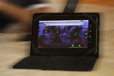

i have bought a china Tablet with msm7227_ffa as a model name written.
i am facing few difficulties in the tablet
firstly i am not able to get into recovery or download mode. if i try key combinations like VOL down + Power, tablet stucks at boot screen
secondly i tried to factory reset once it didn't affect any of the data but ended up stopping my wifi and camera :(
My Wifi and Camera has Stopped working unconditionally
when i start wifi it shows "error" below the text.
when i start the camera it says process.com.android.camera has stopped unexpectedly
to it's reference i am sharing the log files. if any one is aware of how to resolve it.I would be very Very thankful

in case you wish to see the make here it is.
