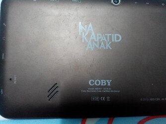

I just want to ask if anybody know how can I fix my Coby Kyros Mid7011 that got bootloop.
I already rooted it using Root Genius but does not have google play store.
So I try to search on how to install google play store in Coby Mid7011. And found an old google market and it work. But when I try to browse again or try to use facebook I'm getting internet connection error. But when I try to play Clash of Clan the net is working. So I try to find other google play store installer. And got gapps- passion.zip.
So what I did is uaing Es explorer extract the zip file and then using es explorer root explorer set mount to r/w both /system and /data. Then what I did is I just manually copy the extracted gapps-passion.zip files and put it in my /system and overwrite all existing file. Thats how I get bootloop because I think the gapps file that I downloaded and put in my system is not compatible with my coby mid7011.
And even factory default dont fix my problem.
my problem are
Got no back up, no cwm recovery installed and that debug mode is not enabled.
Dont know but my only hope is a stock rom of Coby Kyros Mid7011 or update.zip.
Try to download other update.zip
But got OTA verification error.
