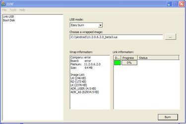

Step 4b: Follow process "1. Burning by OTG" detailed in "Introduction of IUW burning-20110118.docx", as modified below
a) Start "IUW.exe" which may be located in the "iuw1.1-english" folder created when the rar file was unpacked.
Select "Link USB" on the left and "Easy burn" for USB mode.
In the "Choose a wrapped image:" section find your file by clicking on the ". . ." button
b) Select the *.ius file downloaded in Step 2.
"Wrap Information:" should populate with something like this...
Code:
Company: error
Board: error
FileNum: 11.2.0.6.2.0
Image List:
U0 (246 KB)
RD (173 KB)
LK (2376 KB)
ADD_USER (4.5 KB)
ADD_AS (62934.5 KB)
d) Under "Link information:" the box under "Dv." should be green. If it is grey then check your tablet to make sure it didn't timeout and boot up. Also, make sure "Communicating with PC..." is shown on your tablet. The box may be green but if the tablet screen is blank the burn will not work.
"Click "Burn"
You should see the progress bar get to 100%
e) Upon "Burn Completed!" the tablet will ask you to pull the OTG cable and restart
f) Press the "Reset button" on the back of the device using the tip of the stylus, then turn the power on like normal. It will then go through the whole flash update process.
g) The tablet can now be turned on and the system will boot with the new version of Android OS.

Just in case no one has tried yet... I flashed my EX7 with the "11.2.1.5.2.0_beta3_1.ius" file. I just tried to do an OTA update and got an error. That made me wonder.... so I shut it down and did the 3 finger salute. It asked for the key press to recover. I did, then it did. Wiped it clean to a fresh flash of the 11.2.1.5.2.0_beta3_1.ius file.
That is a good sign. we need to look for that part of the code to isolate. Then go back and see if we can pull the update part of the stock install to include in later patch works.
I don't think I will take advantage of the return & replace offer they are giving. But I will root and ADB the stock Tab and pull everything out of the file structure and start going over it to see if we can come up with a way to "un-yaff" the file. or what ever.
cfrocket was the one to find the SD card boot wrapper PRG... I am thinking he will find the PRG to de-compile these files. :) (no pressure)
st0ne
Mar 1, 2011
218
12
OK let me rephrase that.... BEFORE I did the recovery I got an error when trying to OTA update... but I did it again AFTER the wipe and it's D/l'n now... fingers crossed...
st0ne
Mar 1, 2011
218
12
Well it downloaded ok. and it went through the steps of updating... but nothing changed from the flash of the "11.2.1.5.2.0_beta3_1.ius" file.
Gotta look for the update code from an LP7 to see if it can be re packed to push to an EX7.
