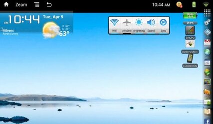

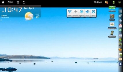

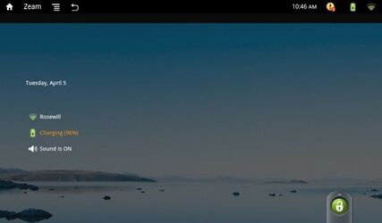

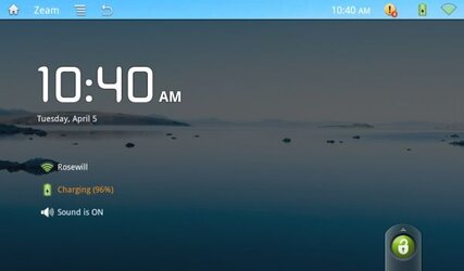

The good news is that there's a free app called LCDDensity for Root (https://market.android.com/details?id=lv.n3o.lcddensity) which allows you to increase or decrease the LCD density. Here are some examples, with the native gTAB display on the left, and the right with the modified LCD density set at "135":
In general, I prefer the higher density display, but it's interesting to note that it can mess up: notice the lock screen is missing the clock on the "modified" version. The notification bar is also a little wonky. I'll upload contrasting screenshots of Dolphin HD in the next post.

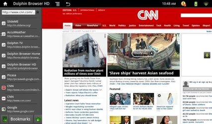

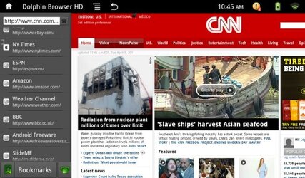

And here are two more comparison shots:
-Matt
