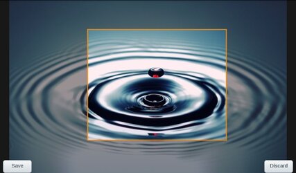

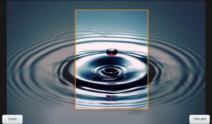

Something has been driving me crazy: sometimes when I try to resize an image for wallpaper, the NC insists on using a portrait (vertically oriented) frame for cropping. Doesn't matter how the NC is oriented...when I go to resize/crop the image, I get something like this:
And of course the aspect ratio is fixed: no matter how you stretch the frame, it stays the same shape. Even when the image is in landscape. This ends up with wallpaper images like the one in the OP, which are narrowly focused on the center.
But today, by accident I pushed the "Discard" button and WHAT??? A new frame appeared:
Resized the second one, and PERFECT.
Not sure if it's happening to other folks...? Please report back if so.
-Matt
