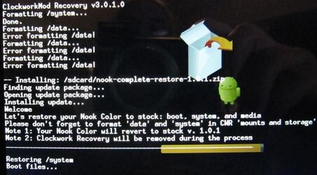

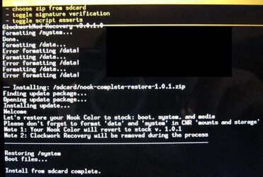

Same problem here.
After Formatting system... it says "Done."
But after Formatting /data... it says "Error formatting /data!"
I continued and it finished with the message "Install from sdcard complete."
I unmounted the card and rebooted. It did start with the B&N movie and registration steps.
But it still remembers the password for my network and connects to the internet. I'd like to be able to fully restore to Factory Settings.
