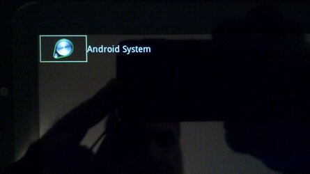

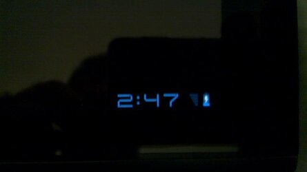

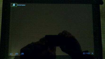

when i turn on tablet normally i have a black screen like this without any response

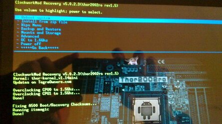

when i go to recovery mode i have this
and i cant do any thing i can move on cvm menu options by vol. keys up or down but when i pressed power key for choosing this options my tablet turn off instantly and i cant choose any thing
i can select options by a usb mouse and by this way i wiped an formated everything like system,data,cash,and flexrom and install new rom like thor14.2 but nothing changed
