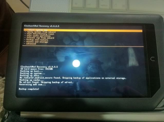

Rebooted into recovery, made the backup, did the reboot system now with the sd card still in the NC,
but everytime it reboots, the "future of reading comes up", the N logo for a split second and it boots straight into clockworkMod Recovery v3.0.0.5. With or without the sd card installed it just boots back into it.
Any Help ?

no matter what i do, it just keep rebooting into clockworkmod recovery. :-(
popped the sd card out, plugged the NC into the computer with the USB, boots into Clockwork again.

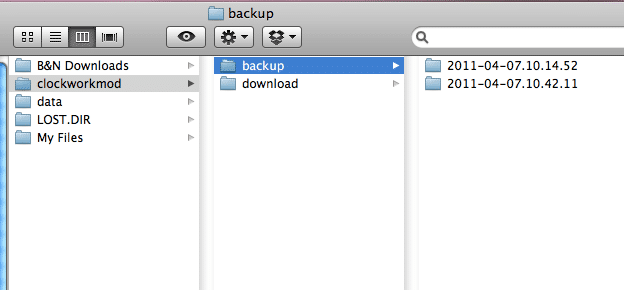

it look like it worked..
view of the sd card
