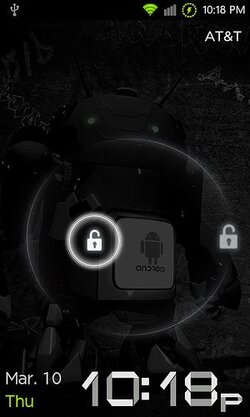

one thing i MISS is the battery icon from the Froyo build that had the percentage in it. there is a slick round one that came with my Phoenix ROM that I think came from ROM kitchen or somewhere...check out this screenshot. where the lightning is is charging, but when unplugged it is a percentage number.

lfom
Developer
Sep 12, 2011
1,386
239
A battery icon with percentage is in my list for the release version. This one if for testing only. Thanks. ;)
