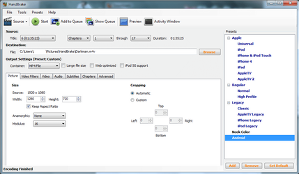

Using the following handbrake setting, you will get files that will play perfectly on your xoom. OK guys, so here it is:
Start off with selecting the 'iPod Legacy' profile.
Then go into 'Picture Settings' and change the width and height to 1280x720
(If you want to achieve better quality and have a 1080p source, you can set it to 1920x1080)
Make sure that under 'Video' the code is set to h264, frame rate same as source and average bit rate 2200
Next up in 'Audio' select a samplerate of 48 and a bitrate of 160
Make sire that large file size, web optimized, and iPod 5g support are all unchecked and then hit start.
I think we can tinker with those settings (especially bit rate) a little more to get a better picture quality, but the method described above already outputs a prety decent result which plays without any stutter or lag for me.
I just used it for True Grit and it works great! The Iconia shines on movies [now]. Remember, Handbrake is free.
As I now I have 3 more blu-rays...the last one is at full 1920 x 1080. I just changed the picture settings part. Plays with no problems using the standard players on the Iconia. Also, these vids play well on the iPad 2 as well.

What am I doing wrong? I try to set the picture size to 1280 x 720 and the entries continue to default to 720 by 480 (i think). I can't get the defaults to change. I'm missing a button somewhere.
any ideas?
Ken
It's hard to say without knowing exactly what you are doing. Are you on the picture tab? You should see source under that and then a box for Width. Keep the aspect fixed and just type in the width. The height will scale as needed. You should then be able to start your rip.

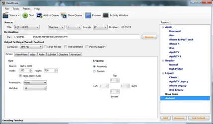

What I did is start with the iPad Legacy profile and then make the changes stated up there. Then I saved this as a custom preset called Android. Now, I just open that present and have a go. If I want to rip at 1920 by 1080, I just make sure the width is set to 1920....
Your picture showed me the problem. When I ripped with DVDFAB it ripped at 720x480 so the convert couldn't make it bigger than the source.
