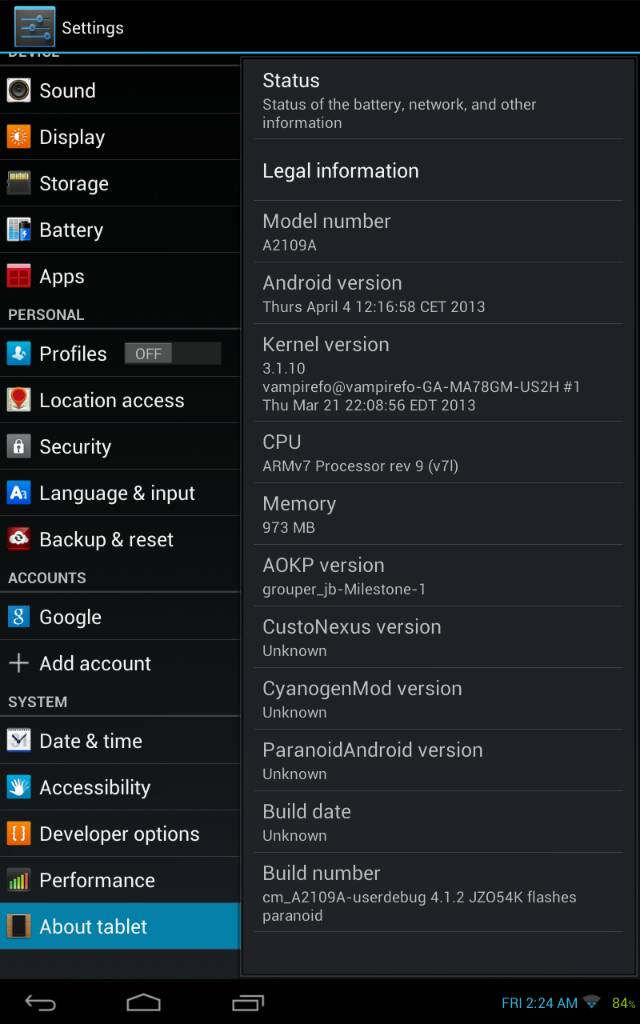

Well here's another ROM for you folks, paranoid android ported from nexus 7
Its a highly customized rom.
All you need to do is factory reset, wipe cache and dalvik.
You may also flash my inverted gapps. If you want the blackout look

Camera does not take still pics but video works

Camera still does not take still pics but video works

I am using vampirefo's cm10 kernel ( thanks and credit to vampirefo )

Ok got rom installed looks nice, I added permissions from cm10 so camera doesn't fc, also added libtcpfinaggr.so, seems it was missing, youtubes kept asking for it found it below.
Goo.im Downloads - Downloading libtcpfinaggr.so
Still looking over rom, i like it, great job flashallthetime, as far as youtubes, I guess I got the one in a million tablet as my sound is fine.
I do get a popup window sometimes that says Unfortunately, the process android.process.media has stopped. other than that rom works well.
I get camera fc when I try and take picture, so not fixed oh well.
