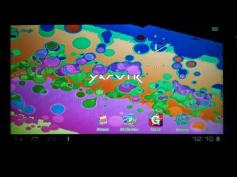

Hi everyone,
I updated my tablet to ICS 4.0, but the colors are now mixed up. The color quality seems also been lower, like 16 bit.
The tablet is a Benign 1029A aka TP-107A of manufacturer Zhuahai Limingz ( TP-107A----ZHUHAI LIMING INDUSTRIES CO.,LTD. ).
The firmware I used was of the brand Yarvik TAB420. Everything work great, even the dead area's on the screen I had with the originale firmware.
What could be the problem (driver, etc) and how can I solve this?

I know how to solve your problem with colors .... is a setting in script.bin in bootloader section, I have your problem and after many week I solved it ...
Have you used a correct ROM for your tablet ?
You have to extract your .IMG file and modify some things in script.bin ...
Tell me if you need my assistance ...
Read this topic:
http://www.slatedroid.com/index.php...-rom Tutorial: how-to fix a A10 Livesuite rom
http://www.slatedroid.com/index.php?/topic/50050-[Q]-Wrong-screen-colors. [Q] Wrong screen colors.

Mister Screech,
I didn't saw your answer till today. I want to thank you for your suggestion.
I can tell you 'IT WORKED'.
Colors are perfect and everything works perfect.
Me very HAPPY.
THNX!!!
