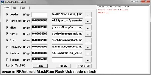

RKAndroidDM program fails to recognise it, even while using the needle trick
what RKAndroidBatchUpgrade 1.23 looks like when i try to use it with an image from the pad site
Pendo Industries Pty Ltd. PendoPad Firmware - Downloads - Support Pendo Industries Pty Ltd.
when i try to use RKAndroidTool_v1.23 (found one that gives english errors)
i get this
for a brief moment it went as far as the batch tool but both get
Start writing ID BLOCK...
WRITING ID BLOCK fail.

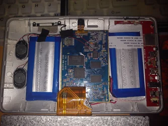

Inside view
http://i47.tinypic.com/b695ra.jpg
link for chip view
i get this

top view
Port veiw : left to right power, USB (modem?), on/off, usb (data), card, microphone
Inside viewhttp://i47.tinypic.com/b695ra.jpg
link for chip view
