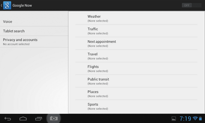

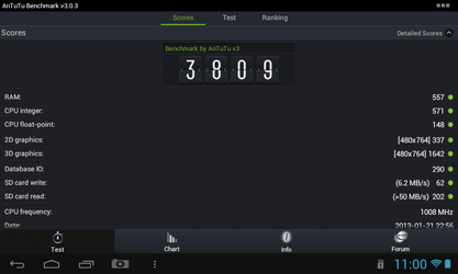

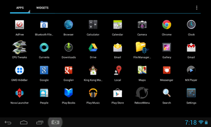

$Screenshot_2013-01-21-19-18-33[1].png$Screenshot_2013-01-21-19-18-53[1].png$Screenshot_2013-01-21-19-19-20[1].png$Screenshot_2013-01-21-23-00-24.png

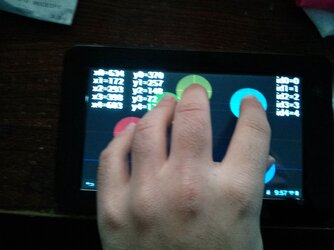

Multitouch does work on my tablet. I tried it on both Chrome and with Multitouch Tester (shows 5 points).
