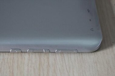

second, you have to know the combination to connect with iuw1.2 and this combination is : upper buttons , press left side button also know as home , keep home pressed for 2 seconds and then without releasing press the power button (the one in the right side) and keep them both pressed for about 4 seconds (until you see the message : comunicating with pc ) ok once you are connected you will see a green light on the iuw1.2 on your computer. that means you are corectly connected with your computer.

So, this is also my question
I posted a picture of the buttons

2 run IUw first , load firmware, with tablet completly off connect to pc with usb cord, hold menu(next to power) + back key(round key on top) then press power button and hold all 3 till screen pops up
