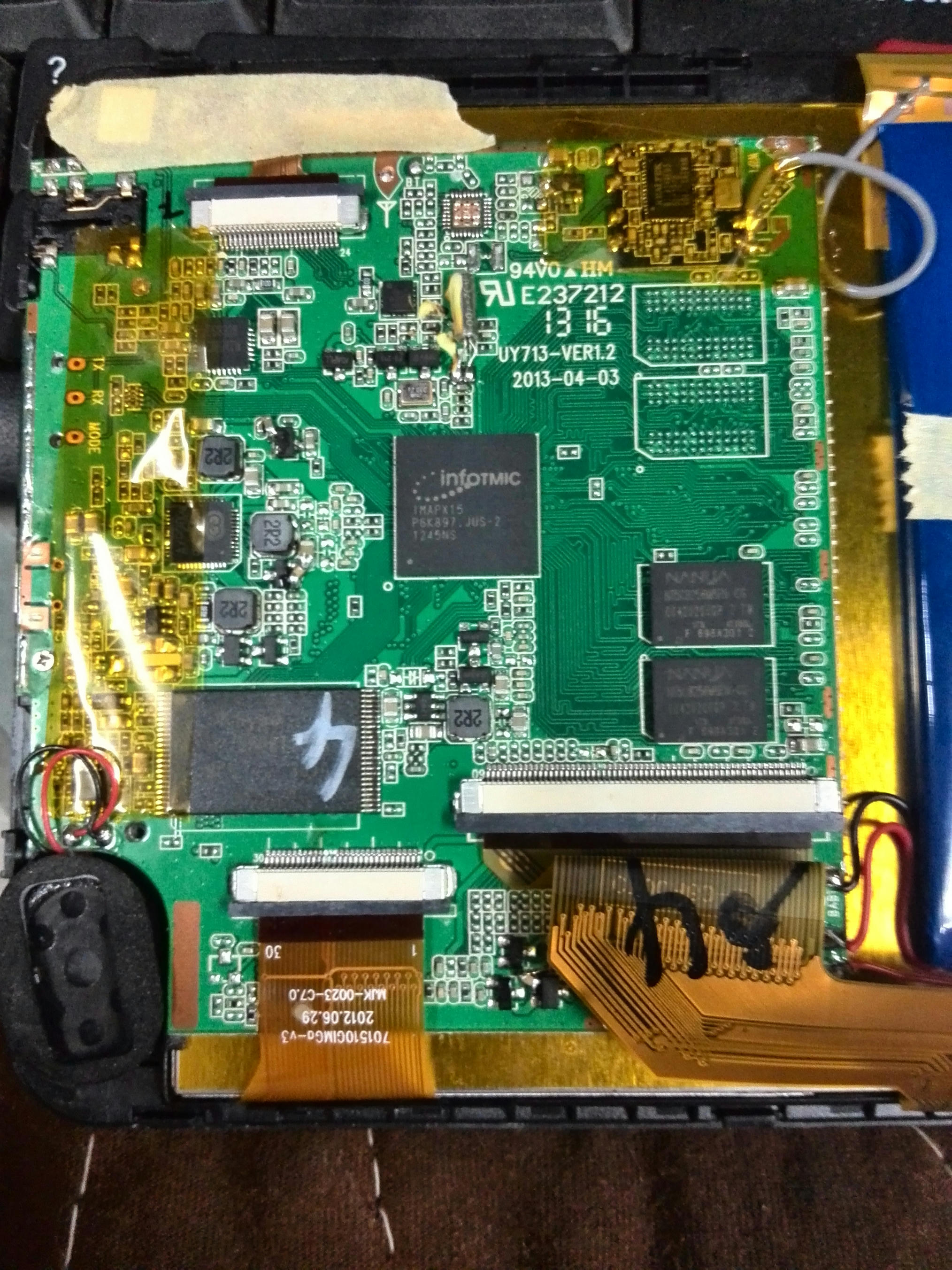

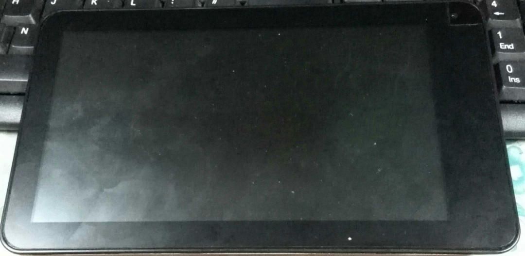

    hi folks
    i hvae coby kyros mid 7057 password infotmic IMAPX15
    anybody know how to reset or format or any firmware to reset the password of this kind of tablet model coby kyros MID 7057 i already search in any forum but im not lucky to found the exact solution
    anyway here is the entire picture of tablet board ID with front and back
    [​IMG]
    [​IMG]

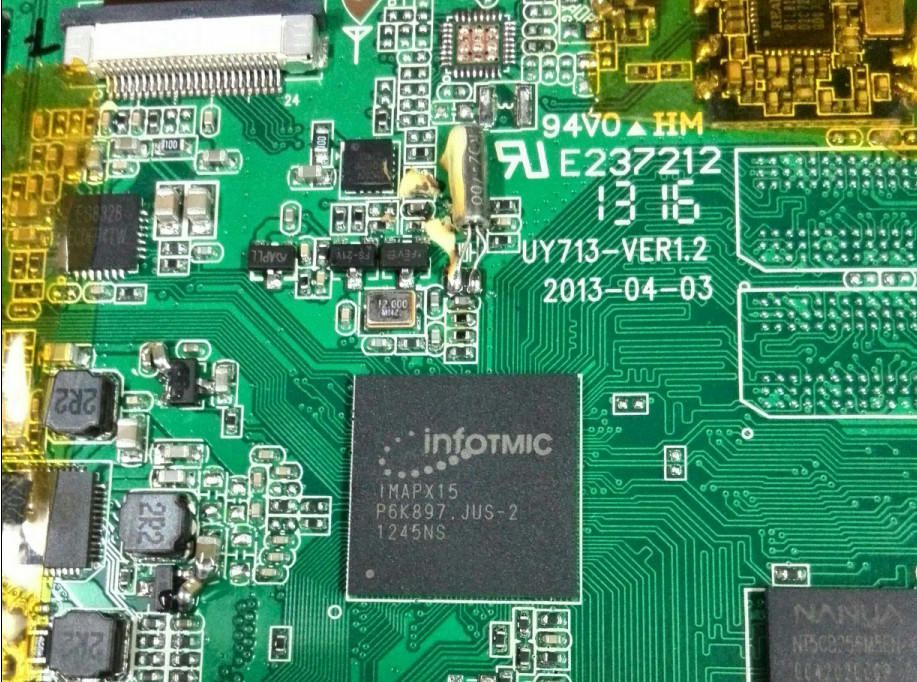

    here is the chip ID
    [​IMG]
    here is he entire board
    http://www.mediafire.com/convkey/c298/j9fgsg0fnmxtl0wfg.jpg
