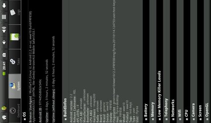

So I received my tablet but am willing to bet good money it is not a flytouch. Once I get back to the house I will post a screen shot of the particulars and see if someone here might know. I keep forgetting others might benefit if they get sent a tablet that is not as advertised. Sorry bout that.

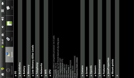

So here are the pics of my tablet: two are of the system info and two are of the outside. I had to use my dropbox account because for some reason I couldn't upload them as attachments to this post. Hopefully these links will work.
http://dl.dropbox.com/u/23650787/2011-3-17-20-41-8.jpg
http://dl.dropbox.com/u/23650787/2011-3-17-20-41-28.jpg
http://dl.dropbox.com/u/23650787/2011-03-17 21.50.49.jpg
http://dl.dropbox.com/u/23650787/2011-03-17 21.49.53.jpg
If someone else can tell specifically what this is then please let me know. I have been using the crap out of Google and it has failed me because I am evidently not asking the right questions.

DWC, you got the FT3(which is really an FT2 Generation 2). I have the same thing and it should be running the latest firmware since you're on 2.2(FRF85B). I've noticed a few things that I'm going to post in another tips/tricks thread as well.
1) Some apps will not install. Unmount and remove your microSD card and most will install now including Angry Birds.
2) The battery drains like a mofo when idle. Turn this thing off(and hit the reset pinhole) or have a charger handy constantly.
3) The speakers are garbage. NOTHING can be done about this. I've tried the audio boost and nothing helps. Go to your nearest tech store, but a pair of battery powered(small) speakers and live with it...or use headphones.
4) Flash in the browser sucks, it works...but it sucks. Grab the Dolphin HD browser from the market to work around this.
I was under the impression the flytouch family of tablets have two tf slots. This one only has the one. And the only apps I have any problems with are the screen shot and its rotation, and Androot doesn't want to root the tablet. It just says failed.
On a different note, can you see the pics in place of the links I used in my post? If so that kind of rocks.
Update: I finally got the Universal Androot to install. I read a few other post that reported the same thing about having to take out the microSD card to get some apps to install. So that is what I did, then just installed the app (I already had it downloaded.) About to go van shopping, but when I get back I am going to have to figure out why my terminal emulator won't launch now.
