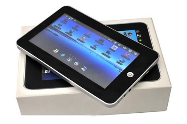

7" MID Tablet Android 1.6 WMT2.1.2_105
The Box is White and the MID print is color black. The Led is Green.
How can I upgrade or unbrick this device.
i tried a lot of roms, it will just say can't find udisk.
Please Help
