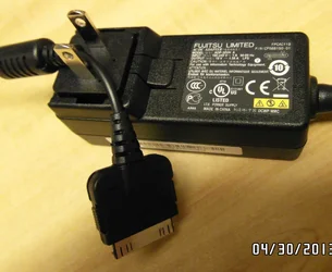

paker
Apr 26, 2013
10
My tablet of less known brand comes with a wall charger, 19V DC 1.5 A, 30 pin connector just like ASUS, I mean the connector. No car charger is available anywhere. I wonder if I can use the ASUS car charger. Would someone kindly check if his car charger has all 30 metals pins in place? Or just a few? I can change wiring as far as all the pins are there. Thanks.
By the way, I doubt 12V and 15V will make a difference. Most likely ASUS has a 2-cell lithium battery. All it needs is 8.4V (4.2 V max per cell x 2). I am pretty sure the chip in the tablet will lower the supply voltage appropriately. $tablet charger.JPG
