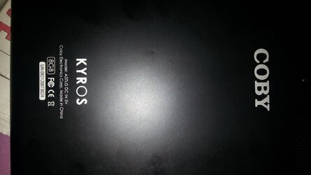

Take a photo of the back of the unit and post it. Just below the Kyros logo it gives the model number. That way we'll know for certain what device you actually have.
i have had a look at that and it says $2012-10-21 17.31.19.webp hope this helps. it was bought from maplins.
thinking of what i can see, dont suppose its a clone of somekind
According to Maplin, it is a 9.7" tablet. However, it does surprise me that it doesn't use the same model number. I wonder if that is a UK specific thing. In any event, follow the "absolute last resort" instructions I gave upthread and see if that works. You haven't much to lose here at this point.
If push came to shove, contact Maplin and see if they can exchange it. Otherwise contact Coby support at cobyuk.com.

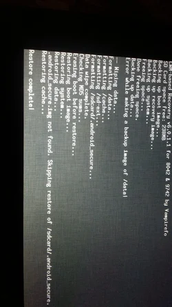

tried your suggestion it went throught he motions to boot, got the coby then android then nothing looks almost as if it has switched of, but when doing the restore i notice a line of text.
dont know if its relevant
The skipping of .android-secure is normal. I have it occur every time I do a nandroid backup or restore one. As to the black screen, that occurred after the Android logo, correct?
yes and then nothing. but not just a blank screen but black with no light
When it got to that point how long did you leave it on before shutting it off with the power button?
i have gone back into cwm done a wipe of everything and done another restore rebooted and left it but still nothing
The internal hardware must be sufficiently different on your tablet that my nandroid won't work, and neither will the dumps on here. I think you're going to have to contact Maplin and look into an exchange.
