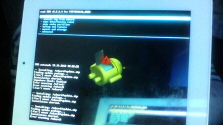

[h=2]Prestigio - PMP7280C3G V4.2.2[/h]I'm in ( rua1 CWM v5.5.0.4 for PMP7280C3G V4.2.2 )
I
got to the part where I need to install SuperSU-v1.65.zip it has options such as this one ( install zip from sdcard ) so I click the Tablet power button to choose it then from there I choose ( apply /sdcard/update.zip ) then it says...
-- installing: /sdcard/update.zip
Finding update package...
E:Can't mount /sdcard/update.zip
Please does anyone know what I need to do.
Any Helpful Steps on things to check and do and any Information will be much and greatly Appreciated.

?????????? you are trying to install SuperSU-v1.65.zip yet you tell the recovery to look for update.zip, do those names look the same to you? they don't look the same to the recovery either. So either rename SuperSU-v1.65.zip to update.zip or look for SuperSU-v1.65.zip.

Thanks for letting me know I will rename the SuperSU-v1.65.zip to update.zip also would you by any chance be able to guess if thats a reason as to why it doesn't mount the sdcard where the file zip is located.

I have renamed it to update.zip and still nothing E:Can't mount /sdcard/update.zip
Anymore Help will be Appreciated. ( I also took a photo hopefully you will b able to see the situation.
You need to compare your stock recovery recovery.fstab with the one in CWM v5.5.0.4, seems they are different.
