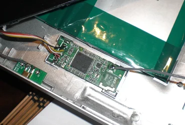

My FT2 is only willing to connect through wifi when I am standing right next to the router. Tried at another rooter, same. When I open wifi settings, sometimes for 2 sec it shows excellent signal, but after few sec it goes down to poor or zero and remains weak until I open the wifi setting page again.
Firmware is 1561, router set to WPA2.
I opened the device to check the wlan module, but couldn't see any problem with solderings. Anyway, I have attached a pic, maybe you will recognize if there is a problem. While opened, there is a small difference in range but still 1/0 bar.
Would a firmware update help, or is it a hardware issue?
Any help would be appreciated! Thanks a lot!

It might just be the picture, but the center conductor on your antenna lead looks like there's more flux than solder holding it on. I replaced my antenna lead with a tyco laptop internal laptop sticky antenna (don't know what else to call it). It wasn't the easiest thing to do since the solder connections are so dang close together, but it was doable. I haven't really noticed much range improvement, but picked up maybe a couple db via "wifi analyzer". Try applying some heat to the center conductor on that solder joint (make sure not to short the two legs).
