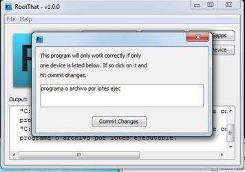

Well, finally had some time to try it. Everything went fine until I got to the actual rooting step. UnlockRoot23 says the device is already rooted and asks if I want to root it anyway. I select "yes", but after a while, I get an error saying "Failed to get shell root!". So I tried with RootThat, and got the dialog hat you can see in the attached image. Not sure if I should select the text that appears there and hit 'commit changes'. What puzzles me is that the device name doesn't appear there but a random piece of text. Any ideas?

What do you get when you run adb devices command? I'm really not sure what that funky spanish message is all about. It's possible the apps may not work for gingerbread. Try some other tools around and see if any can succeed.

As for the error message, I realized it was due to the path to the windowsstart script containing spaces, so I renamed the folder without spaces, ran the script again and this time the device was detected properly. However, I get the following message when trying to root it:
