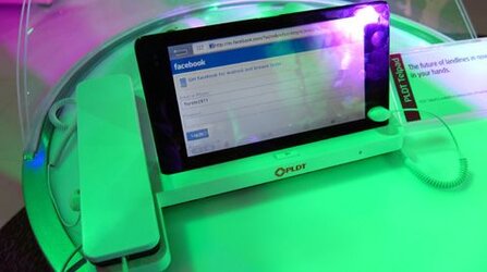

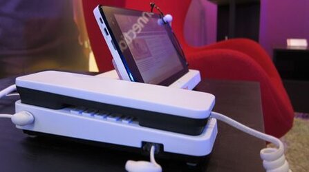

Just experience a problem with my huawei s7-201w, market wont open then I tried a reset and got stuck on fastboot and tried restarting the unit but it keeps on booting on fastboot, i had no choice but to repgram the unit with a compatible firmware, now my problem is pldt dialer application is not available at the market... Is there a third party app available to work as my dialer for the dock that came with tablet, or will there be someone to upload a backup app of the dialer...
The first time I had to reinstall the firmware I used one of the Indonesian roms(S7-201u). It has a dialer app built in. My tablet was the wifi only model so I found the rom for the US model S7-201w, and used that.

Thanx for the INFO... Will it be possible to extract the Dialer App from that Indonesian ROM and install that to a US ROM? Or is there any third party App available for me to use...
Update...
Got to Load a ROM from a S7-201u but the Dialer App is for Mobile use and not for a Landline Docking System...
Im back with US s7-201w B016, still hoping for someone with a rom or app with a dialer for my landline dock, sure will solve the thread starters problem as well with mine...
