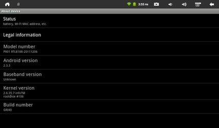

Finally got my new pad today... ABOUT device looks like:
and have started attempts to root it.
(Yes, already! :p )
Apparently it does not have SU anywhere, which is necessary for rooting.
z4root supposedly runs to completion but it seems that it doesnt actually do it.
The other pad with:
has SU in /system/xbin...
The new one does not have /system/xbin but does have /system/bin... which does NOT have SU....
Anyone have ideas as how to get an SU into the folder?
