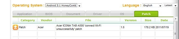

Patch online today for wifi connect issue

i had to factory reset several times and then install the patch before i could connect to wifi. it seems to have worked now, as i have disconnected, rebooted, and still reconnect to wifi. usually it hangs in obtaining ip address loop. keep at it, in case it doesnt work at first. i will update if the poblem starts again. hopes this helps someone.

Wow, I hope I don't have to go to that much trouble, but thanks. What I get is it starts to load the update.zip at boot and the progress bar starts, but then immediately the Android icon changes to have a triangle with an exclamation point, then if I leave it for awhile it just reboots.

So I just finished installing the patch, seems to be working but won't know for sure for at least a day or so. Interestingly enough, however, I can't seem to get the update to 4.010.10 that they recommend installing after the patch... oh well, if it works I'm happy for the moment.

I put the patch on my tablet and just get the android with yellow explanation point in triangle - anyone else get this to work>>> There is a ROM out there supposed to be stock 3.0.1 - has anyone rolled back and reupdated?

OK - well must of been a bad download the first time - this time worked like a charm........after this update I completed the download of 010.10 patch and installed - states successful - will see.....that's what the 3.1 said too. lol

That's what mine did when I tried running the update the first time, and the second time. I found I had two issues, or perhaps only one since I have no way to know at this point if the first was the problem since it still failed until I fixed the second.
1) I tried running the install without a full charge, 95% not 100%. The instructions do tell you to make sure you have a full charge, so check that.
2) I had installed the patch via usb, but pasted it to the SD directory and not the external SD directory. After I had these things squared away the update ran fine.
Best of luck to you.
