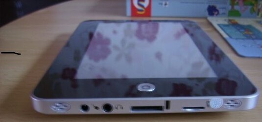

i buy from china a 7"android tablet.
it is work good
my seller says it is a GOOMAX?
And i wont to have the tablet is going faster.
My problem is, i have a firmware from flytouch installed. start tablet-->the picture with the green android roboter is dancing -->android letter is comming
-->after this stop the system. Thats the wrong firmware. I have it install from myself that was not right, i now.
:eek:
I put in the item the sd card with the firmware original in the slot.
Switch on
The system from flytouch is starting
1 have only 1 Message "Preparing to install" thats a message from original Firmware!
after this is starting the flytouch system until the android letter is running and stop .
i can install windows ce, it ist work but without sound and touch!
i wont to have the android but it doesnt work
There is no vibrate if i switch on ?
and i looking a lot of android forums an try al lot of firmwares in the internet
the item is that a GOOMAX ? i cant not more informations in the internet.
maybe you have a idea?
Thank you again for your answers

It looks like my flytouch 2 as it has 24 pin data socket. I wrongly flashed mine with eken roms which loaded and win ce which worked without sound or touchscreen. No other roms wanted to install and just like yours got stuck on preparing to install.
I eventually found that original rom should be WMT2.0.1_88. There is a rooted with market version on these forums somewhere.
