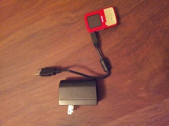

So this is the thing I have to charge,can I just stick it in the nook wall charger and charge it on the wall?
I'd be careful about using the nook charger to charge other devices because it puts out a higher charge than most devices (more amps).

I figured that and so I used the charger of an old phone and it worked...thank you JP:)
