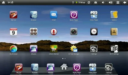

Below is a shot of the homescreen (in case that helps) and the page I get when I go into settings. Is this enough for you people to help me?
View attachment 4741View attachment 4742
