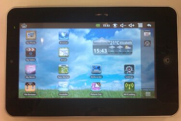

Hi All,
I have one of the 7" tablets sold in Australia under the brand name Neo Pad.
Brand: Neo Pad
Model No: NEOPAD8650 (Device reports as WonderMedia WM8650)
Available at: http://www.oo.com.au...P91175C5993.cfm
CPU: ARM926EJ-S rev 5 (v51)
BogoMIPS: 299.00
Memory: 512Mb (site says 2GB but it's obviously only if you get it with a 2Gb MicroSD Card)
Screen: Resistive (2 finger multi-touch) 7" running at 480 x 800
Green Power LED
Vibrates on Startup
Power, Black Headphone, slot for USB x 2/ RJ45 Ethernet Extender and MicroSD slot at bottom as well as two speaker holes
(attached pictures show position as well as, Menu, Vol +/- buttons on right side, Power on top, reset on left and back button on front.)
WI-FI
NO GPS
NO 3G inbuilt (but 3G USB dongle ready)
Accepts up to 32Gb MicroSD
Running: Android 2.2 (Kernel 2.6.32.9-default) Build number: generic-eng 2.2 Froyo v1.2.3-20110414.152957
I would greatly appreciate any assistance you can provide in helping me root this device.
Cheers,
Rastarn
