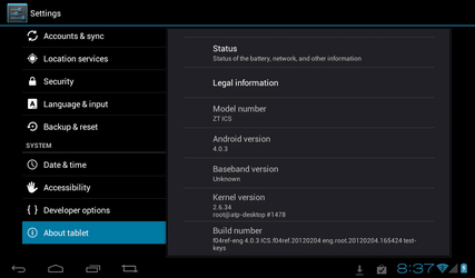

I've searched this forum and did not find an answer.
I just got my ZT-282 two days ago. How do I know if it needs the upgrade? I've attached tablet info.
Thanks for the help!

While the official designation of the Upgraded C91 is zt-280, many call it the zt-282 to distinguish it from the original C91.
This also appears to be Zenithink's thinking as they label the firmware upgrade for these machines as belonging
to the zt-282.
The source for the firmware is here, just click on the next word, Zenithink.
The firmware has been upgraded on 07/02/2012.
If you haven't upgraded your hardware since this date you need to do so now.
The process for doing this is simplicity itself.
1. Download the firmware package.
2. Unpack the software
3. Place the zt-update folder in the main directory of the sd card.
4. Make sure that your tablet its fully charged or plugged in, and charging.
5. Shut the tablet off.
6. Holding the camera button down, and then pressing the start button will bring up a screen indicating that the tablet firmware is updating. At this point, everything is automatic.
The upgrade will be done in a minute or two.
